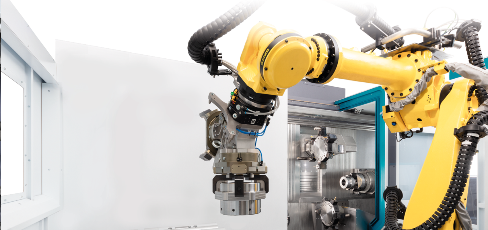

- 6-axis robot for 7.5 kg payload with integrated gripper control
- Double gripper included in the standard

The overall sequence between the machine and the robot cell is created using predefined macros in the NC program. The robot accesses the machine’s work area via the sliding door, which opens and closes automatically. The iXcenter has a modular design and allows you to integrate different processes economically. Thanks to the accessibility of spindles, tool carriers, and the tool magazine, iXcenter makes you ideally prepared to set up your machine.

- Robot capacity: 165 kg – higher weights possible in special cases
- Optionally up to 270 kg capacity
- Robot reach approx. 2660 mm
- Self-contained robot cell
- Basic cell as a complete delivery unit with load-bearing base unit – modules supplied separately
- CL return to machine – walk-on floor with grating
- 6-axis robot with up to 270 kg load capacity
- Double grippers in flange or shaft versions
- Optional: Automatic gripper change, including gripper storage
