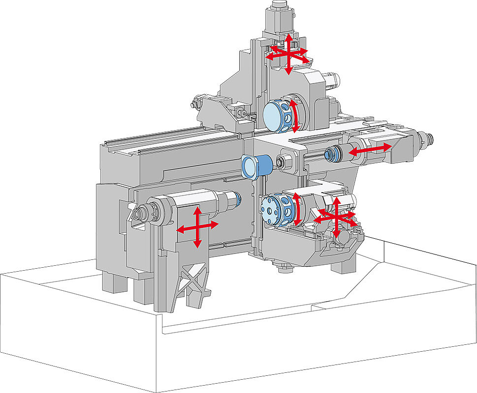

Machine concept
The machine concept of the TNL20 has been systematically matched to the daily requirements of the user. So the kinematics of the machine allows effective and simultaneous machining with two or three tools.The generous and vertically arranged work area provides for the necessary degrees of freedom, as well as for very high process reliability. The machine's crucial productivity advantage is the result of its extraordinarily high dynamics. The newly developed machine bed from gray cast iron forms the basis for utmost vibration dampening properties. And the high rigidity and thermal stability ensure optimum workpiece quality.
TNL20 in focus
TNL20-9
Simultaneous and precise manufacturing with up to three tools.
TNL20-9B
Version with the additional B-axis for highly complex parts.
TNL20-11
with additional front attachment - with four tools produce simultaneously, precisely and even more economically.
