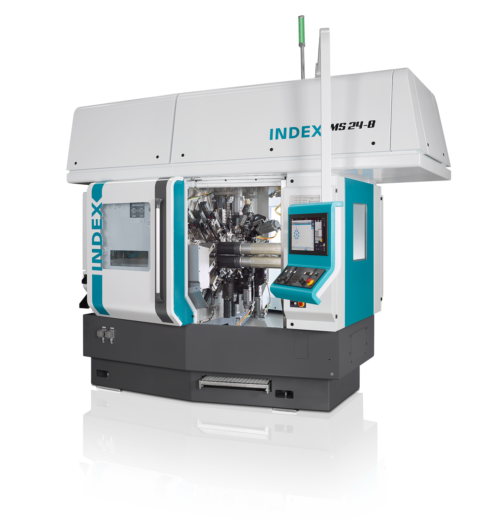

Productive multi-spindle machine with 8 spindles
8 main spindles, up to 2 swiveling synchronous spindles and up to 16 tool carriers.
  • Freely accessible working area, making setup particularly easy
  • Highly-dynamic slide with sliding guide (X axis)
  • Quick machine setup with INDEX W-serration
  • Non-wearing Z axis due to quills with hydrostatic support
  • Front-opening machine for bar machining
  • Chucked part machining
  • Directed part discharge through linear handling
  • Extremely fast swiveling synchronous spindles with C axis
  • Swing arm is locked by three-piece Hirth coupling in machining position, ensuring maximum rigidity
  • Maximum of six tools for rear-end machining per swiveling synchronous spindle
