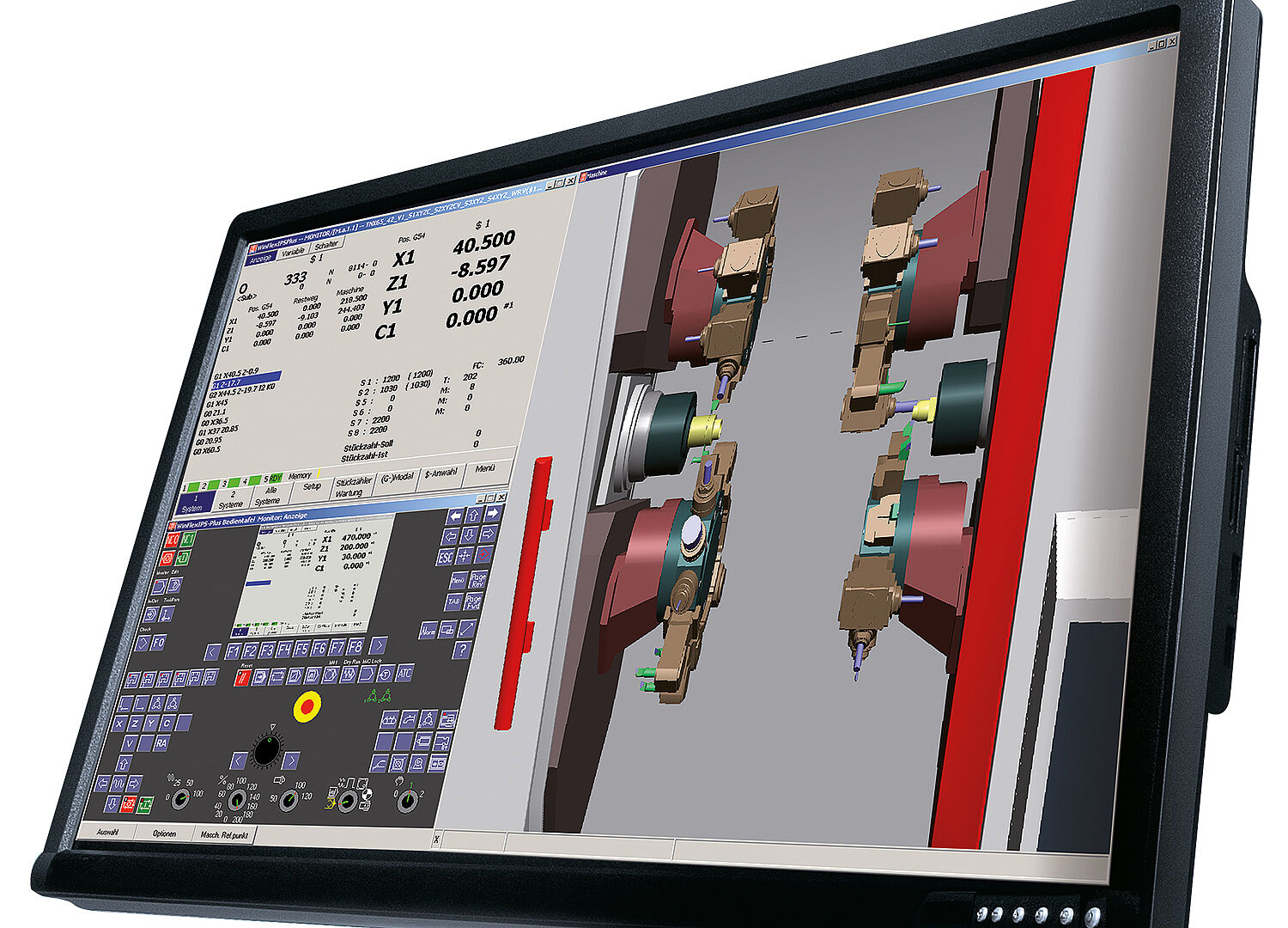

In addition to powerful programming, optimization and simulation functions, WinFlexIPSPlus offers the “Setup and Automatic Mode” in the 3D model, just as if you were standing in front of the machine. This gives the user, in addition to the previous advantages of WinFlexIPS, also the real 3D model and all the operating elements, including their functions, of the real machine – and all of that on the PC!

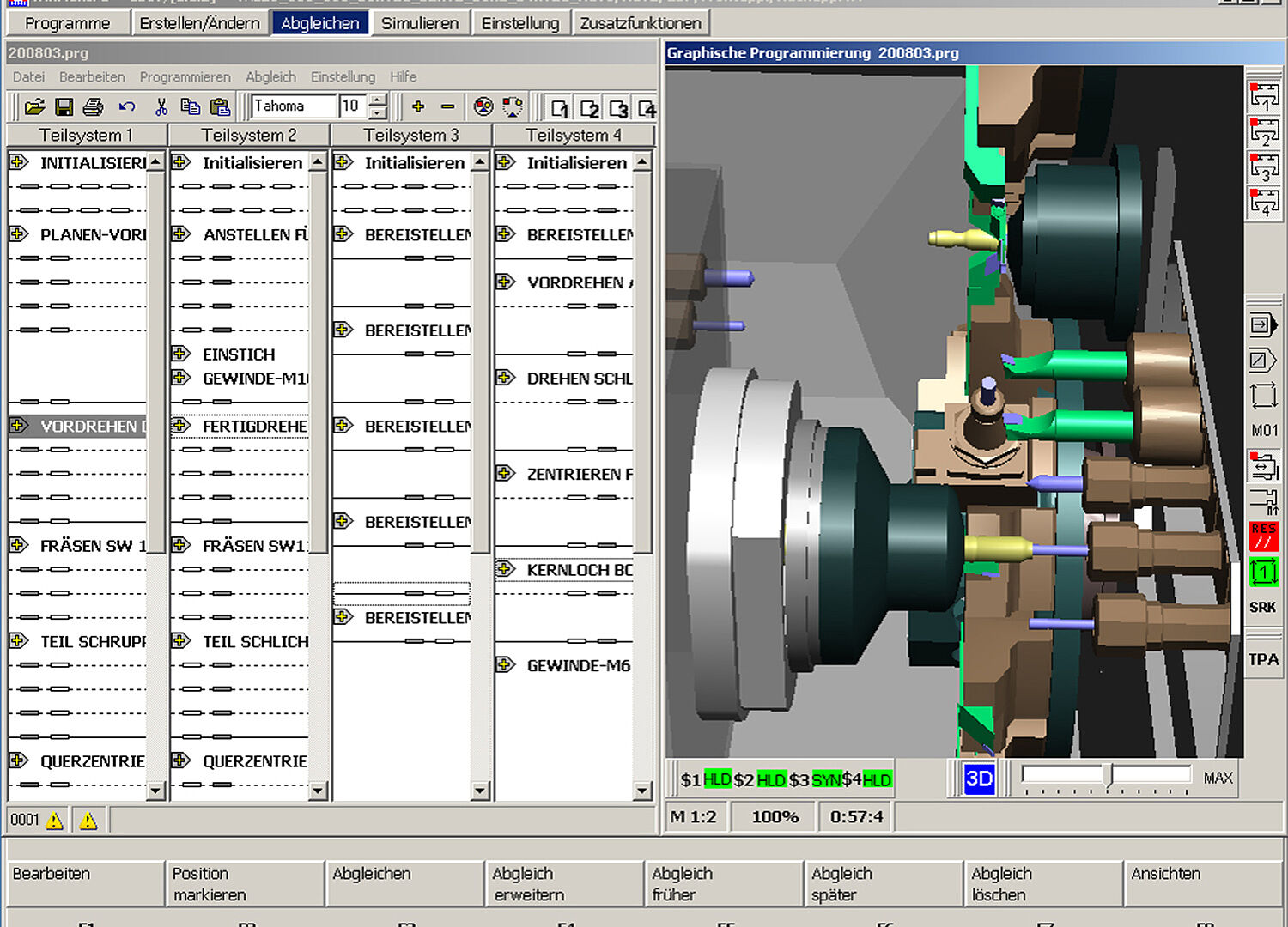

  • Fast and reliable programming as a result of optimized standard program elements
  • Clear depiction of the program sequence in plain text
  • The NC program is available immediately following the graphically interactive input and can be executed at once
  • Change between dialog input and NC single block input is possible at any time
  • Program optimization directly in the simulation model
  • Simulation optionally in 2D or 3D on the basis of the NC program in TRAUB format
  • Planning and optimization of the setup process with the functions ‘manual operation’ and ‘automatic operation’ in accordance with the real machine.

With WinFlexIPSPlus, machine usage planning, work area investigations or setup planning in the 3D model can now already be carried out on the PC with the additional function ‘manual operation’ in accordance with the real machine – virtually exactly as if you were in front of the machine. This optimizes the set-up and programming process and ensures considerably shorter set-up times, increased process reliability and improved machine utilization. Furthermore, WINFlexIPSPlus can also be used extremely effectively during instruction and training of control and operating functions for TRAUB machines and as an aid for optimizing the introduction phase of new machines and to train new staff. The user can thus move training times from the machine to the PC workplace and save production times.
