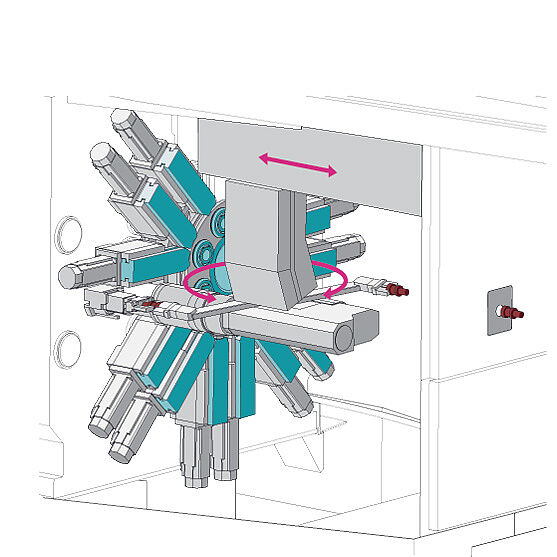

Linear shuttle with intermediate gripper for directed parts removal from spindle position 8
Very rapid, position-oriented removal by a linear and rotary motion. The workpiece is transferred first from the synchronous spindle to the intermediate gripper. The linear shuttle then takes the workpiece from the intermediate gripper and passes it to the external handling system. This process takes place during secondary processing time.

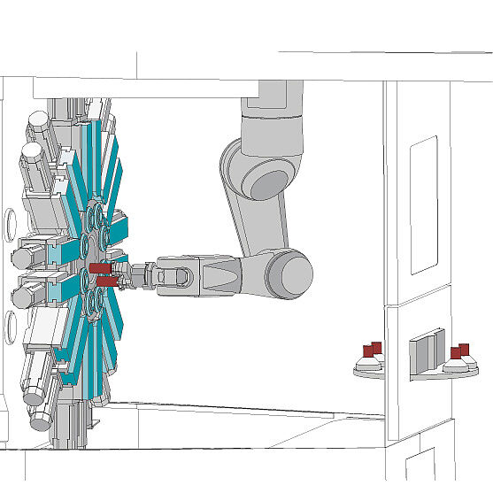

Parts feed and discharge by 6-axis robot
The workpiece handling system for chuck parts and bar segments can be used for 8-spindle machining with and without synchronous spindle, as well as for double 4-spindle machining.
A variant
4x OP10 (first side) and
4x OP20 (second side) with external turning station is also possible.
3-axis linear shuttle for directed parts removal from the synchronous spindle
Damage-free and position-oriented delivery of components from the synchronous spindle in position 8 or 7 and 8 to the external handling system at the front of the machine. All 3 axes of the machine-integrated handling system are NC-controlled.
