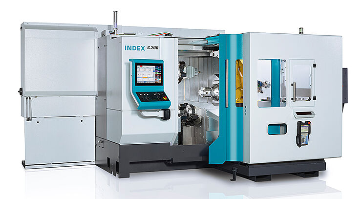

G200.2
Turn-mill center
  • 65 mm spindle clearance
  • 165 mm chuck diameter
  • 660 mm turning length
The INDEX G200. Flexible turning and milling - as productive as automatic turning.
The next generation of the turn-mill center with more performance at minimum space.
  • Up to three tool carriers with Y-axis usable on main and counter spindles
  • Simultaneous machining with up to 4 tools possible

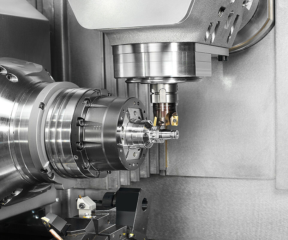

  • Powerful and dynamic milling spindle (360° B-axis, max. 7,200 rpm, 22 kW and 52 Nm, HSK-A40)
  • Economic complete machining of parts as well as of bar stock and as of chuck parts
  • Incomparably large degrees of freedom in the large work area for turning-milling operations with up to 660 mm turning length
  • Excellent ergonomics for quick setup
  • Compact foot print an enormous power density for economic manufacturing

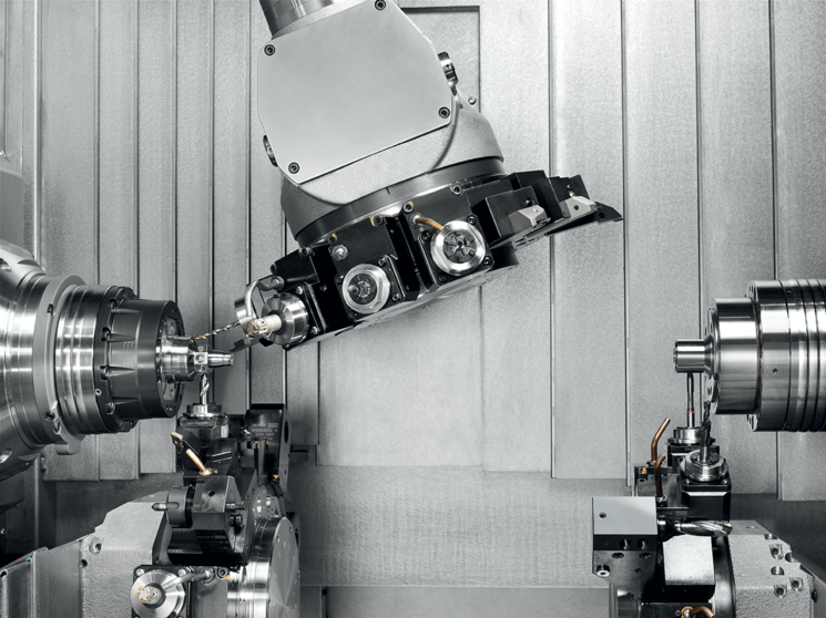

With a high degree of rigidity, thermal and dynamic stability as well as very good vibration-damping properties, the G200 enables production with excellent workpiece qualities.
The powerful milling spindle, in connection with the Y/B-axis running in hydrodynamic bearings ensures sophisticated drilling or milling operations – without the use of live tool holders – easy and cost-effective.

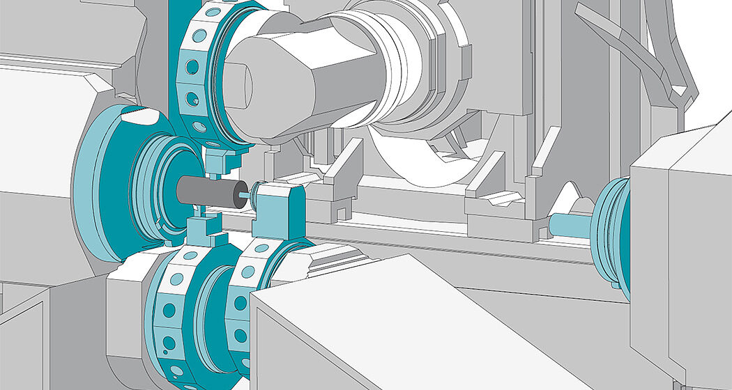

Up to three tool carriers with Y-axis and a maximum tool pool of up to 42 stations (VDI25) are usable on main and counter spindle of the turn-mill center. Even a tail stock or a turret steady with a clamping range of 10 to 66 mm are possible within the configuration of the G200.
Wide variety of machining options
Incomparably large degrees of freedom in the work area

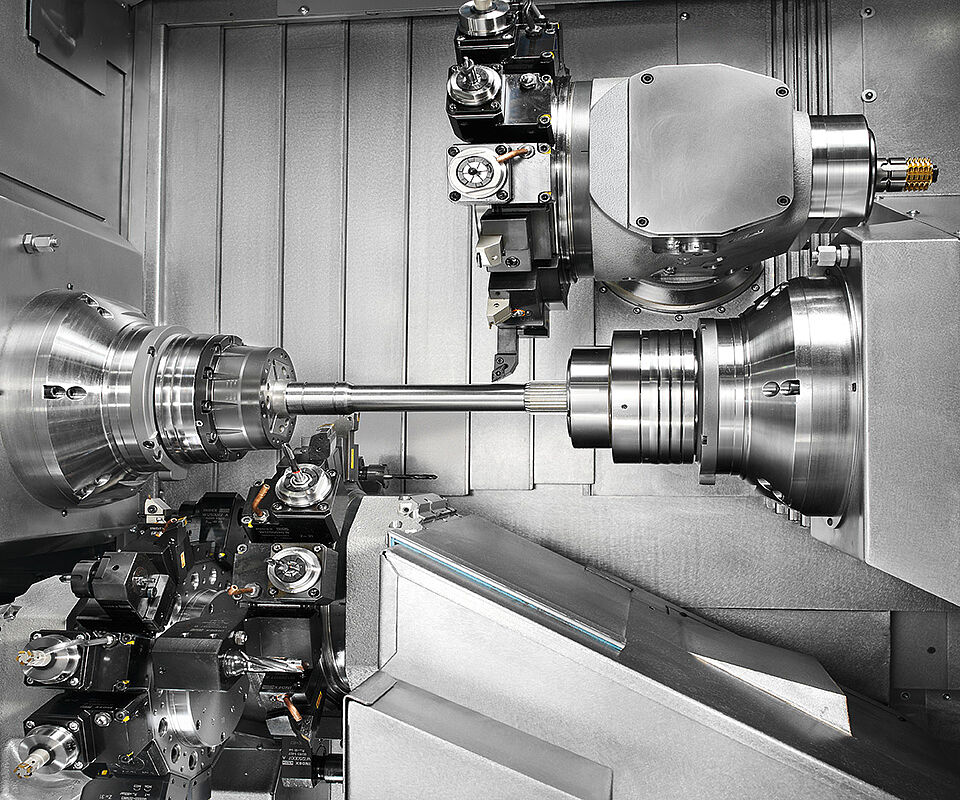

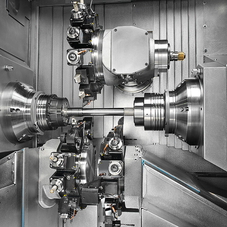

Machining with up to four tools at the same time
Machining of long workpieces without interruptions with turret 2 or turret 3 in parking position.
Simultaneous internal machining on main and counter spindles
Simultaneous machining with three tools on the main or counter spindle
