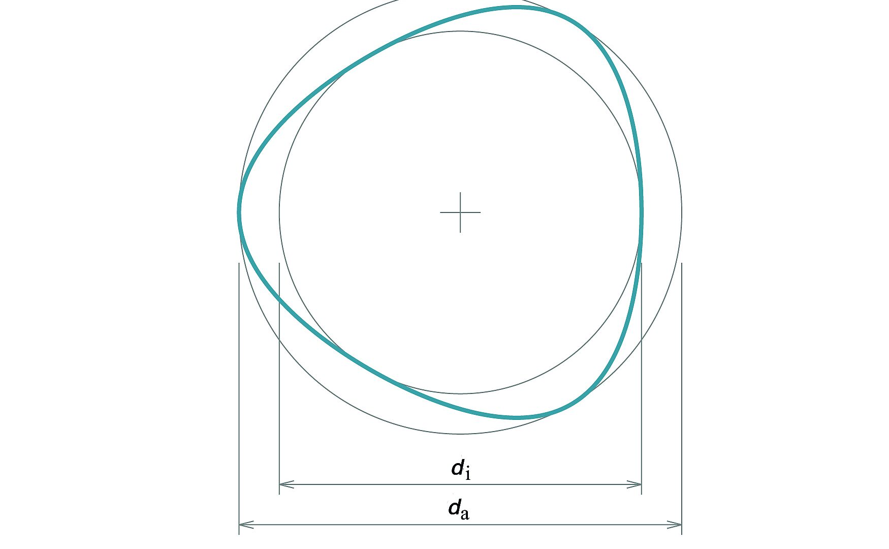

Standardization
This type of shaft/collar with polylobe connection has been standardized in DIN 3689-1 “Shaft to collar connection - Hypotrochoidal H-profiles - Part 1: Geometry and dimensions” since November 2021.
According to this standard, a polylobe profile with three sides and a minimum circumscribed/maximum inscribed circle diameter of
da = 22 mm and di = 18 mm
is designated as follows:
H3 – 22 x 18
