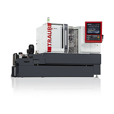

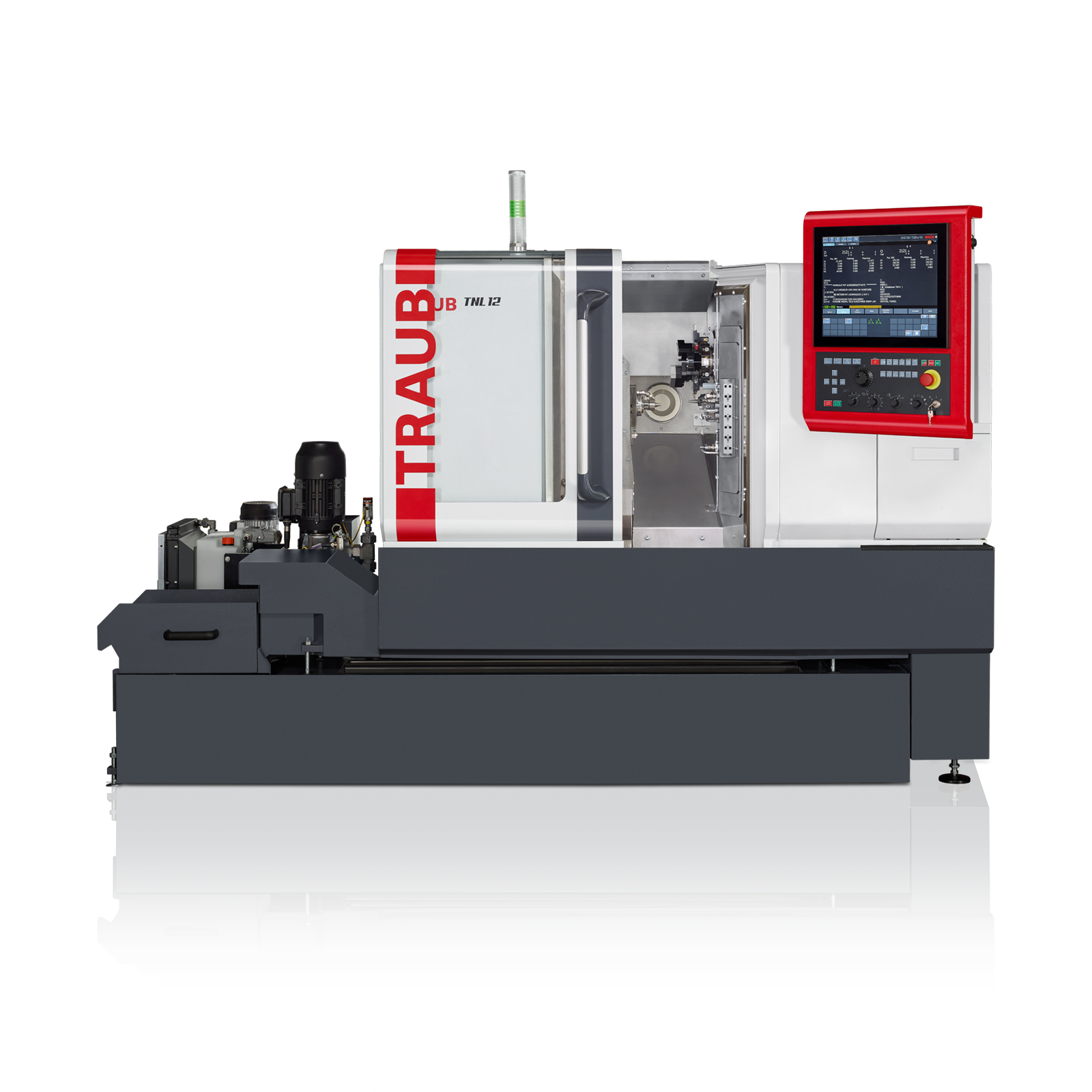

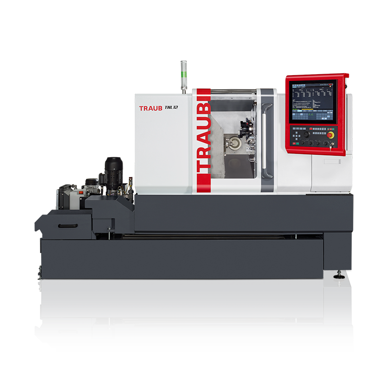

INDEX is introducing the TRAUB TNL12 lean, an entry-level version of its well-established small sliding/fixed headstock turning machine. This machine is confi gured with a single turret and a back working unit, while simplified alternatives are used for other components. The result is a flexible, cost-effective, and highly efficient production turning machine ideal for producing simpler, high-precision parts, such as those required in medical technology.
TRAUB TNL12 lean - Machine highlights
- Easy changeover from Swiss-type to fixed headstock operation
- Generously dimensioned and ergonomic work area
- Extremely compact machine layout for high productivity per unit area
- High accuracy due to thermo-symmetrical design and cast iron machine bed
- 2 liquid-cooled 4.4 kW motor spindles ensure high dynamics
- Live guide bushing with a carbon drive sleeve
- Tool turret offers greater flexibility in tool setup compared to a linear unit
- Swiveling control panel with a large 19” multi-touch display
- Workpiece flushing via the back working unit
- Optional second workpiece container and workpiece selector
- Comprehensive software package and new-generation control system
- All options can be configured as needed
- Best performance for applications in the medical technology, optical precision engineering, electrical engineering industries

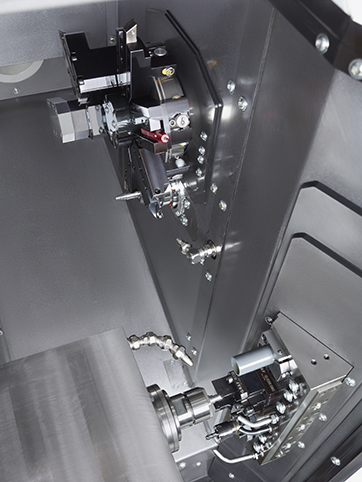

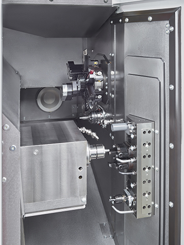

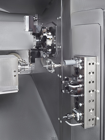

- High-performance main and counter spindles with a spindle clearance of Ø 13 mm
- Two tool holder subsystems (tool turret and back working unit)
- Short tool change times owing to the CNC indexing axis in the tool turret
