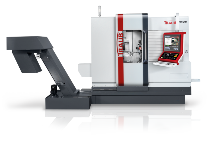

TNL12
Sliding headstock automatic lathe
  • 13 mm spindle clearance
  • 12,000 rpm max. speed
  • 130 mm max. Z-travel

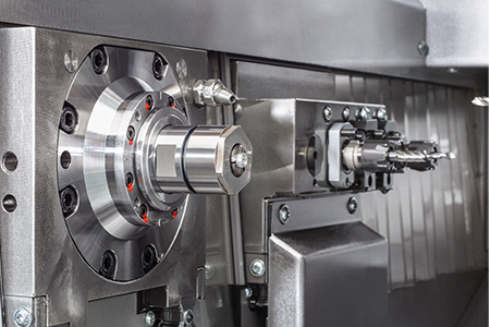

TNL12 – sliding headstock turning machine
Compact sliding and fixed headstock automatic lathe for precise machining of small workpieces
  • Bar clearance up to ø 13 mm

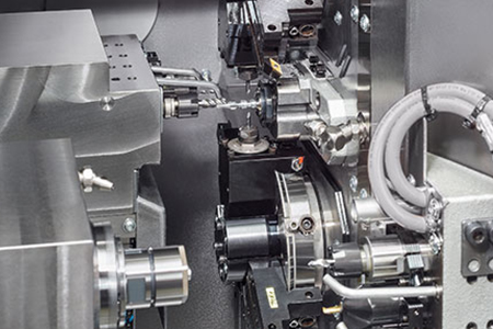

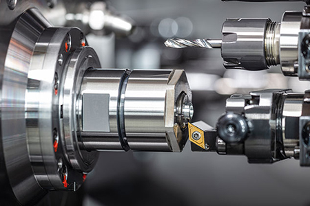

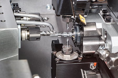

  • Up to four tool carriers for simultaneous tool use

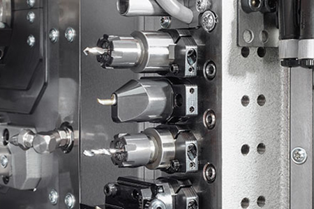

  • Large tool pool for setup-friendly production
  • Brief tool change times thanks to CNC indexing axis in the tool turrets, front working attachment and back working attachment
  • Easy changeover from sliding to fixed headstock operation
  • Extremely compact machine layout for high productivity per unit area

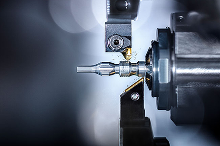

The TRAUB TNL12 sliding/fixed headstock automatic lathe is a further logical development of established production technologies. Whether as a Swiss-type sliding headstock lathe or for highly productive use as a fixed headstock lathe, the configuration options from the modular system are extremely diverse and sufficient to meet even complex requirements.
